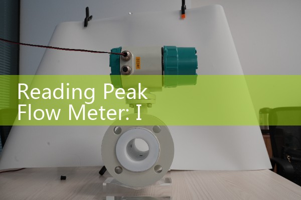

Electronic Scale Peak Flow Meters
Electronic peak flow meters store the maximum flow rate in onboard RAM or via a 4-20 mA HART register. The local LCD shows a peak value that you can cycle through with a push button. On Silver Instruments electromagnetic flow meters, the display toggles between instantaneous flow, forward total, reverse total, and peak flow limit. The peak value appears with a small triangle icon or the letter P on the upper right of the screen.
Access the peak log menu. Press and hold the right arrow key for 3 seconds. The screen flashes PEAK and shows a value like 17.34 L/s. This is the maximum flow since the last reset. A water treatment plant in Lagos used this function to track backwash surges on a DN150 electromagnetic flow meter. The peak flow jumped from a normal 28 L/s to 44 L/s after a sand media change. The electronic peak data told the team the filter nozzles were rated correctly but the pump soft starter was bypassed.
Electronic meters often timestamp the peak event. Read the date and time stamp carefully. A simple 4-20 mA loop meter may not have a clock, but smart meters with Modbus RTU output log the peak with a time string. In abrasive slurry applications, a peak at 2:17 AM during unmanned shifts indicates a valve slammed shut. An alumina refinery in Western Australia diagnosed a broken check valve using this logic.
Resetting an electronic peak is menu driven. Never reset the

peak before you save the value to a shift log or SCADA historian. Some Silver Instruments flow meters automatically push the peak register at 15 minute intervals via a Modbus poll. If you clear it manually, the historian loses the record.
